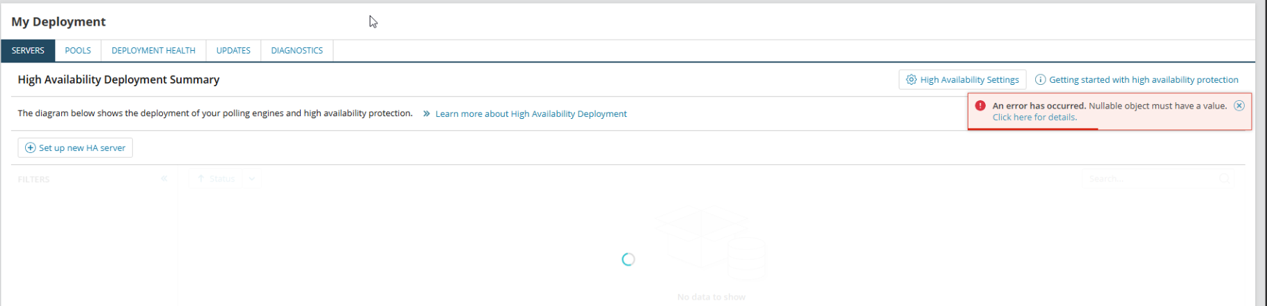

Starting SolarWinds Platform 2025.2, the High Availability (HA) tab was migrated to two separate tabs called Server and Pools.  For more information about these changes, please reference the SolarWinds Platform 2025.2 release notes.
After upgrading to SolarWinds Platform 2025.2, the following error message appears when navigating to Servers or Pools tab under My Deployment:
An error occurred. Nullable object must have a value.
The observed symptoms includes:
  • Navigating to Servers tab results in a blank page with the above error message.
  • Navigating to Pools tab results in a blank page with the above error message.
