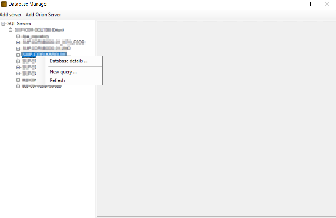

  3. From the Orion server, go to Start > All Programs > SolarWinds Orion > Advanced Features > Orion Database Manager.
  4. Click Add Default Server to connect to the SQL server that hosts the Orion database.
  5. Expand the SQL Server, and then right-click on your Orion database.
  6. Select New Query.
  7. Paste the following query:
    Note: xxx is the ID found in the warning message.
    update views Set LimitationID = '0' where limitationID = 'xxx'
  8. Click Execute Query.
