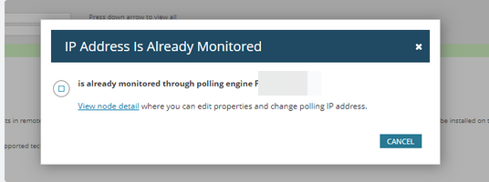

When adding a node in the Orion Platform via Settings > Manage Nodes > Add Nodes, users are allowed to input node information, select objects to monitor through the "list resource" page, and successfully pass all polling tests. However, upon attempting to add the node, an error message appears indicating that the node is already monitored through a polling engine.

This issue appears to be a regression caused by recent changes aimed at addressing deduplication issues. Specifically, modifications made to handle cases where interfaces from one node are assigned to another have inadvertently broken the functionality of the add node feature. The issue arises when the device being added, whether polled via WMI or SNMP, does not return a sysname value in the OID or WMI query. Consequently, the system mistakenly identifies the node as already being monitored.
