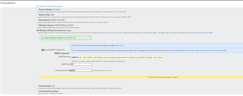

"Test failed. Selected engine is down" error when adding SNMP credentials on an Agent node in 2025.4
Unable to add SNMP credentials to an agent node, even though the SNMPwalk passed.
11/24/2025 9:58 PM
7/1/2026 3:57 PM
On a Linux-agent node, when trying to add an SNMP credential, you may get the error "Test failed. Selected engine is down."
Network Performance Monitor
This has been identified as a known issue in SolarWinds Platform 2025.4.
This issue is fixed in SolarWinds Platform 2026.1 and newer. Consider upgrading your environment.
