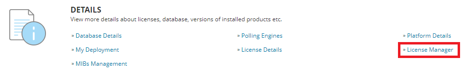

- Navigate to Settings > All Settings > License Manager

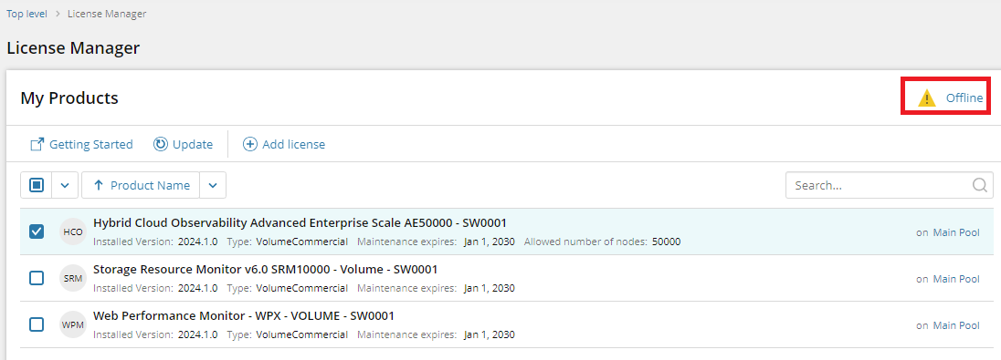

- In the URL, append "?offline" at the end. For example:
- There will be an indication on the top right that the License Manager is in offline mode:
- Select product.

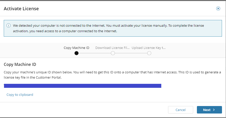

- Click Update if you are renewing the license or Add license if this is a new license activation.
- Click Copy to clipboard
- Navigate to the SolarWinds Customer Portal
- Navigate to License Management underneath the activation key, click Activate License Manually
- Complete the fields, including entering the Unique Machine ID you copied earlier > and Generate License (.lic) File.

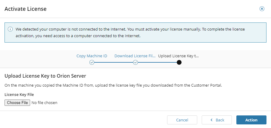

- Navigate to Settings > All Settings > License Manager > Update/Add License
- Click Choose File
- Select the location where the license file (.lic) was saved to.
- Complete the steps, then click Action.
