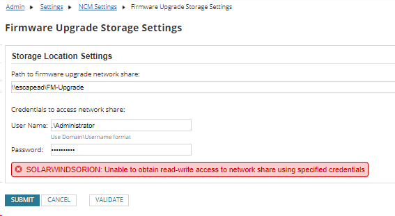

In this article you will learn how to correct the following error received while adding a firmware shared location:
Firmware Upgrade storage Unable to obtain read-write access to network share using specified credentials
Sample Screenshot:

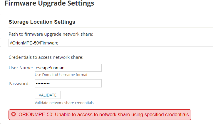

You are providing an incorrect password or credentials, or the permissions to the folder are not appropriate.
Please do not use NON-English characters within the username/password, for example (Arabic / Turkish / Greek )

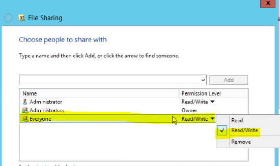

4. Check the File Sharing permissions for the folder and verify that Everyone is granted Read/Write access.

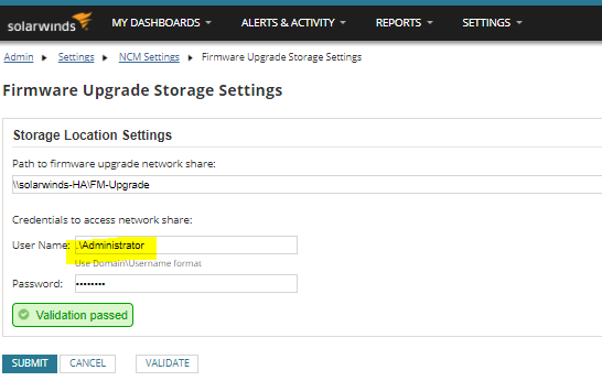

If you are using local authentication use the .\ user as shown below.

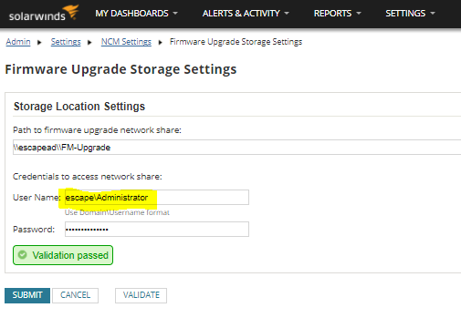

Domain:

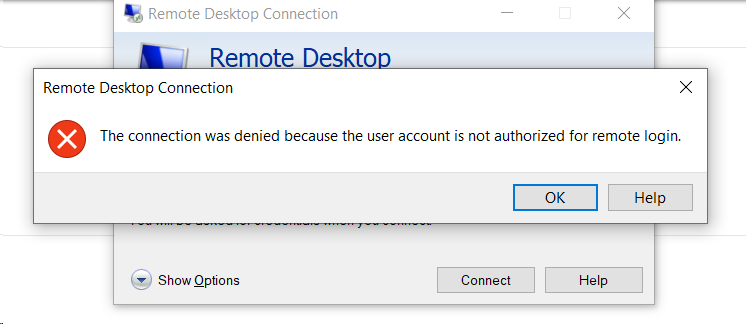

Make sure the domain user is granted permission to logon into the target NCM server,
Try to add the Domain Account to the Administrators Group on the target server and validate credentials again in NCM,
Please consult with your windows team to grant appropriate permissions, make sure the user is allowed to log on locally on the target server,
