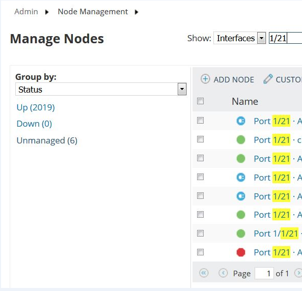

Users may use the manage nodes resource to locate and search on interfaces
The Manage Nodes resource is used for managing nodes and the filtering is based on the nodes.
As an example:
The Show Interfaces search option is used under Group by Status. The Up, Down and Unknown refers to the status of the node and not the interfaces as shown here. You can see in the Up selection that the interfaces are in a Down state because the Group by applies to the Node status and not the interface status.
