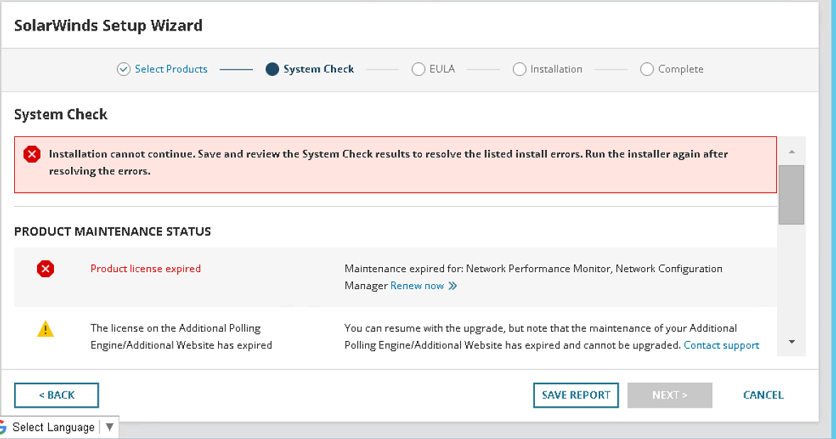

Scenario 1: The installer fails due to the license being expired in License Manager.

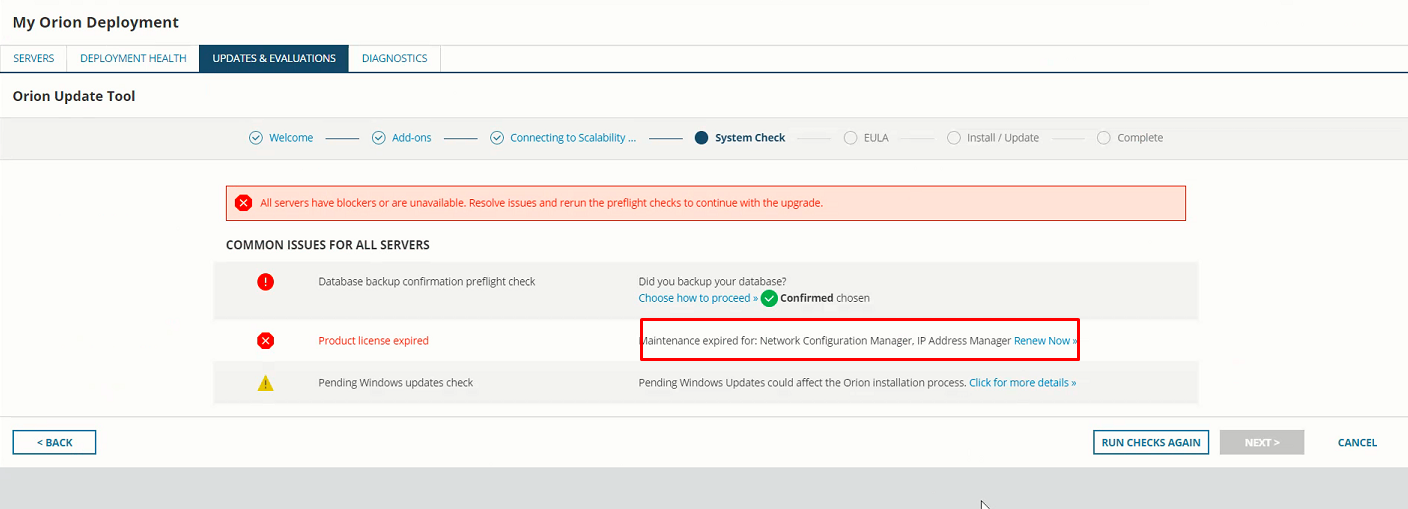

Scenario 2:  The centralized upgrade tool does not let you proceed after System checks because expired licenses are detected in your license bundle.

  1. Confirm if any of the licenses mentioned in the error are expired.  If you have a new license for the matching module, then apply the license either via online / offline method and retry upgrade.
  2. If the licenses mentioned in the error have expired and not renewed, de-activate the corresponding license and retry the upgrade.  When moving to SolarWinds Observability Self-Hosted licensing model, it is important to deactive all the previous licenses, then apply the new license as any expired license will cause the installer to fail.

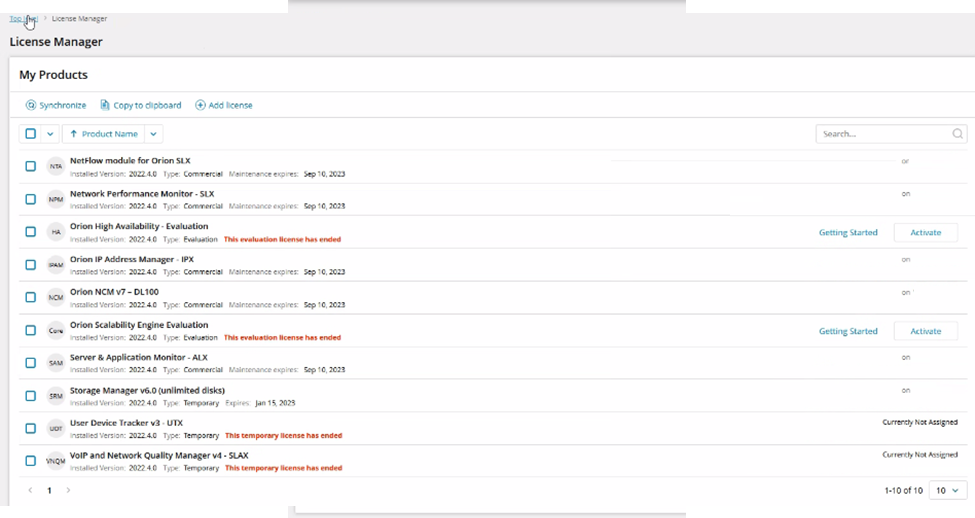

    1. Select Cancel
    2. Open Menu Settings > All Settings > License Manager

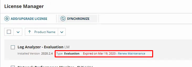

    3. Select the Expired product (Example Log Analyzer)

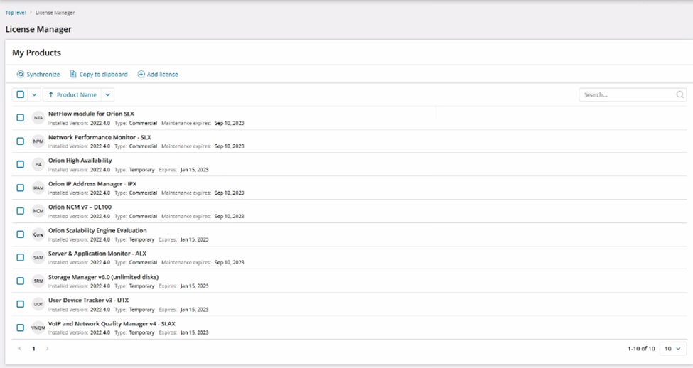

    4. Click over Deactivate Option. (With this option, the License key will be removed and the upgrade blocks will let pass this condition. The next Image is displaying the license, once the expired key was deactivated.image.png
    5. Test again the upgrade with Centralize Updated and will not display a block for expired licenses.

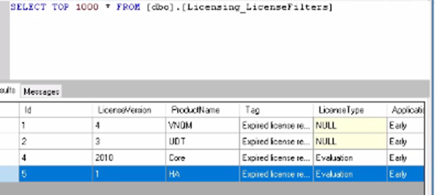

  1. RDP to the Orion Server.
  2. Open the Database Manager
  3. Open the table for Licensing > Licensing_License Filters
  4. Check for Expired licenses.
    Note:  Deleting the Expired Licenses in the table would not help in bypassing the error.

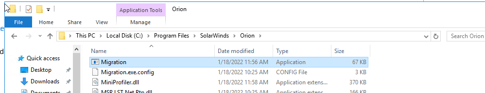

  1. Go to C:\Program Files \SolarWinds\Orion.
  2. Run the Migration.exe file as administrator. Kindly refer to the article Corrupted license store in Orionimage.png
  3. Access the License Manager via the Web Console.
  4. You will now see the Expired Licenses.
  1. Add temp license to the Expired licenses. Click on Add license if there is no activate button.
  1. Once the licenses have been activated, run the installer once more and you will no longer see the error and the installation wizard will push through.
