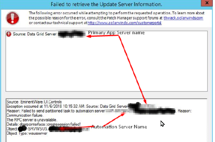

When attempting to push an update, the task fails. Looking in Task History, you see the tasks fail with this error: "Failed to send partitioned task to Management Server <PAS>. Reason: rpcsessionmanagerproxy::instance()->execute() failed with Exception. Message: Object reference not set to an instance of an object..

When you publish an update, the task fails and generates the following error in Task History:
"Failed to send partitioned task to Management Server <PAS>. Reason: rpcsessionmanagerproxy::instance()->execute() failed with Exception. Message:  Object reference not set to an instance of an object.. Call Stack:    at EminentWare.Core.Server.Jobs.ManagementServerJobOrchestrator.ManufactureJobs()
This error also occurs when you try to pull WSUS/SAS server details using the Server Publishing Wizard.

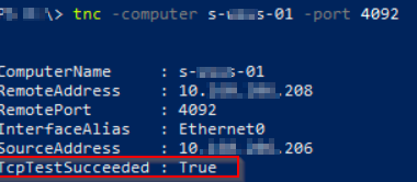

Datagrid Service Port Access Validation: This error might show up when running any jobs targeted to SAS or accessing SAS details or SPM Agent node.
  • To validate access to port 4092 between PAS and SAS (bi-direction) servers or the SPM Agents and PAS depending on source and target devices, follow below process.
# run the below powershell command from both PAS and SAS to verify two way port access
#From PAS to SAS example & expected output.
#From SAS to PAS you should expect same output as above.
tnc -computer SAS_name -port 4092
  • If TCPTestSucceeded is False, then verify the EminentWareDataGrid Service is running on both the Servers via services.msc
  • If the EminentWareDataGrid Service is running and port 4092 is not blocked then verify the deviceID and CADeviceID from the HKLM\SOFTWARE\EminentWare\Data Grid Service registry on PAS
