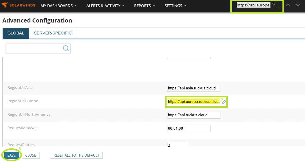

- Log in to the SolarWinds Platform Web Console using an account with administrative privileges.
- Access the Advanced Configuration settings in the SolarWinds Platform Web Console
- Ctrl + F and paste the URL https://api.europe.ruckus.cloud in the search box, and it will directly take you to the URL section.
- Edit and paste the URL for what you are looking for, then save.

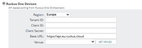

Come back to manage nodes, add the node to Ruckus One, and select the base URL; it will change.
