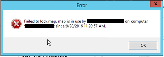

Error Failed to lock map, map is in use for Network Atlas in NPM
When trying to edit a map in Network Atlas some of the maps throwing Error < Failed to lock map, map is in use by [username] on computer [server] since 9/28/2016 >
11/1/2018 9:43 PM
12/13/2021 7:38 AM
This article addresses the following error:
Because of a previous migration, some of the maps had got stuck and were still listed under the old server's name not the current server.
