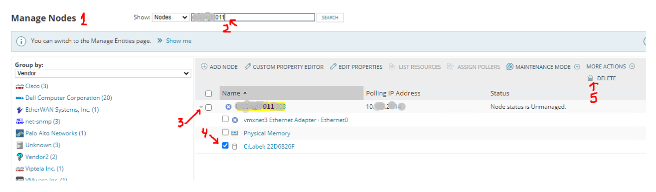

To delete you can search Manage Nodes, Search for affected Node name,
From the above Query you will have this similar information
Example:
Node ID  / Node Name / VolumeID      /Volume Name /             Percentage
92                 Server1           271          C:Label:22D6826F          128.281235
Expand the resources for the node, in order to list the volumes, and select the affected Volume  (VolumeName), and select Delete
