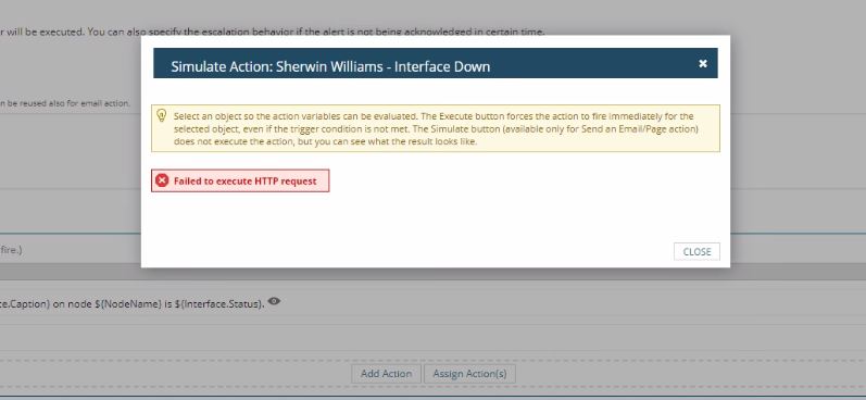

This article provides information about possible error(s) you may see when performing HTTP/S alert GET/POST actions in Solarwinds Orion platform.
The common error you see in GUI is when you do Simulat alert action execution is 'Failed to execute HTTP request'
However, logs may have more details info about exact causes.
