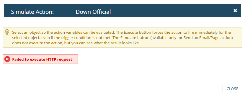

When simulating the alert, you see the error for "Failed to execute HTTP request" when trigger actions are sent to LINE.
You can also use Orion Insights to check the alert action failures.
