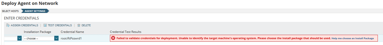

Failed to deploy Orion agent for Linux as unable to identify target machine's operating system
When attempting to remote deploy the Orion agent for Linux, you may receive the following error when testing the credentials: "Failed to validate credentials for deployment. Unable to identify target machine's operating system." You may not have a supported Linux distribution. To resolve, verify your Linux distribution is supported. If the distribution is supported, you may need to manually deploy the Orion agent for Linux using another method.

When attempting to remote deploy the Orion agent for Linux, you may receive the following errors when testing the credentials:
  • "Failed to validate credentials for deployment. Unable to identify target machine's operating system."
  • "Failed to validate credentials for deployment. Authentication to remote host failed."
You have tested the SSH credentials via putty directly from Orion server to the Linux host you are trying to deploy the Orion Linux agent and they work just fine.
Please check the likely causes and resolutions section for fix/workaround.
