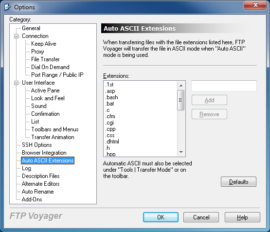

By default, the FTP Voyager automatically determines what mode to use for data transfers (ASCII or Binary). In Auto-ASCII mode, the FTP Voyager uses file extensions to determine which files will be transferred.
To view or edit the list of extensions that FTP Voyager associates within ASCII mode, click View > Options > Auto ASCII extensions.

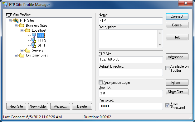

  1. Open FTP Voyager.
    Note: If the Site Profile Manager does not display, click Connect.

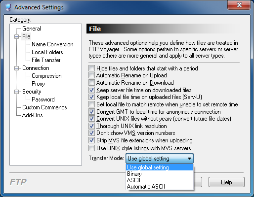

  1. Select the site, and then click Advanced > File.
  1. Select an FTP transfer mode from the Transfer Mode from the drop-down menu, and then click OK.
