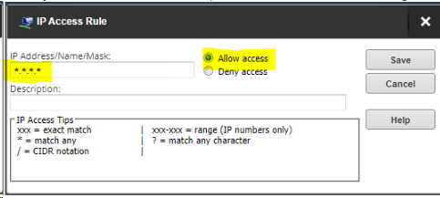

1. This error determine that customer use PORT FTP command with IP different from the origin HOST IP. To Allow this behavior customer require to explicitly allow such IP (which is different from the host IP) at the IP Access rules.
a. To add, navigate to Groups where affected user is associated or in the User's account.
b. Configure IP Access Rules, set Allow: *.*.*.*
c. Save.

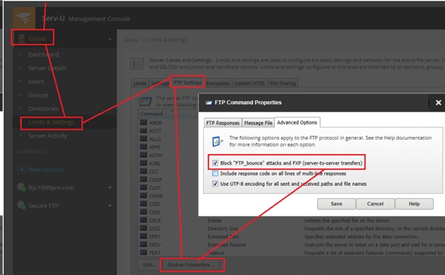

2. If Step 1 did not work, the workaround is to switch off the option "Block "FTP_bounce" attacks and FXP (server-to-server transfers)." The option is residing at Global->Limits&Settings->FTP Settings tab->Global Properties button -> Advanced options:
