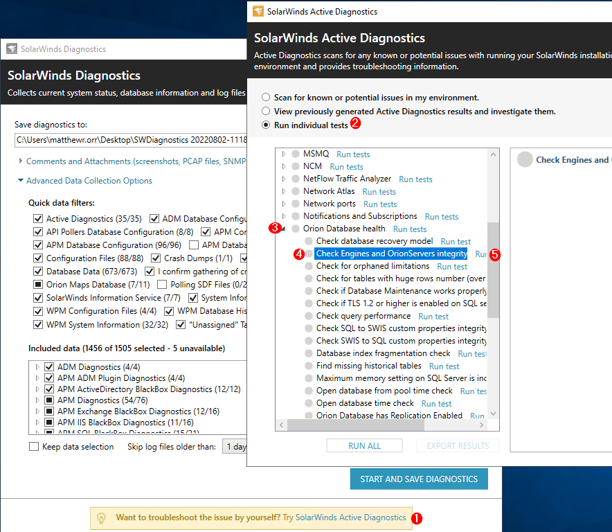

  1. Run the Active Diagnostics test Check Engines and OrionServers integrity.
    1. Connect to the SolarWinds Platform Server.
    2. Open SolarWinds Diagnostics from the SolarWinds Platform folder of the Start Menu.
    3. Select Solarwinds Active Diagnostics at the bottom.
    4. Select Run individual tests, the Check Engines and OrionServers integrity under Orion Database Health.
    5. Select Run Test.
