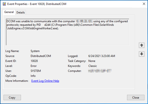

Here is an example of the DCOM error in the Event Log:

Event 10028 DCOM error occurred when the WMI request failed to communicate with a remote node due to Invalid Credentials or an Invalid WMI Namespace on the Target Device. As a result, an event is being logged automatically on your Application Server's Event Logs.

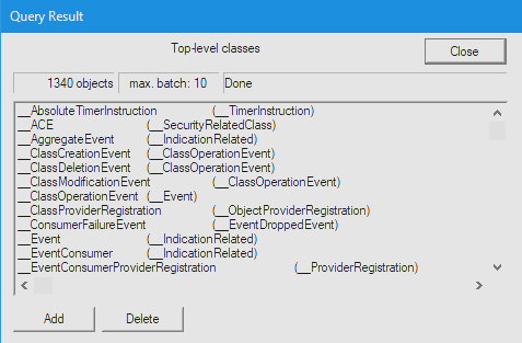

  3. To verify the Error is genuine, you can perform a Wbemtest to verify if the credentials set are valid.
  4. Type WBEMTest in the run dialogue box.
  5. Under Namespace, change root\default to root\CIMV2, then click Connect.
  6. If a second dialogue box appears, repeat step 4.
  7. Click Enum Classes, select Recursive and then click OK. You should see a display of all the CIM objects.
