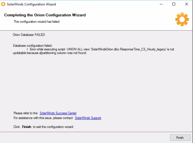

Running the Configuration Wizard hitting the failure below:
Orion Database FAILED
Database configuration failed:
  • Error while executing script- UNION ALL view 'SolarWindsOrion.dbo.ResponseTime_CS_Hourly_legacy' is not updatable because a partitioning column was not found.
