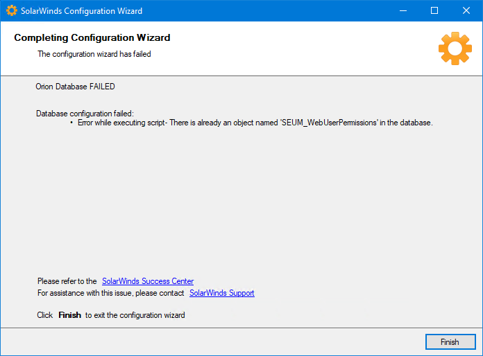

This issue typically occurs when running the configuration wizard during Orion 2022.x upgrade. Running the Configuration Wizard shows the error below:
Orion Database FAILED
Database configuration failed:
• Error while executing script- Invalid object name 'dbo.SEUM_WebUserPermissions'.
Sample Image:
Orion Database FAILED Dataase configuration failed Error while executing script.png

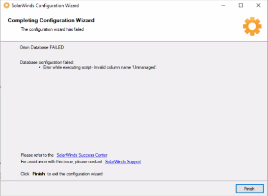

• Error while executing script- Invalid column name "Unmanged".
Sample Image:
Orion Platform
Remnants of previously installed products in the database.
The function needs to be recreated.
  1. Please remove all SEUM tables.
  2. Execute the script to Drop the function
    • -- Scripts are not supported under any SolarWinds support program or service.
      DROP FUNCTION [dbo].[GetSEUMDbVersion];
  3. Please go ahead and execute the script to Create a new function.
      CREATE FUNCTION [dbo].[GetSEUMDbVersion]()
      RETURNS int
      AS BEGIN RETURN 5
      END;
  4. Re-run the Configuration Wizard, and it should now be complete.
