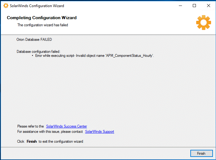

This article will walkthrough how to resolve the following error: Orion Database FAILED Database configuration failed: • Error while executing script- Invalid object name 'APM_ComponentStatus_Hourly'.

When running the configuration wizard, the following error may occur:
Error while executing script- Invalid object name 'APM_ComponentStatus_Hourly.png
