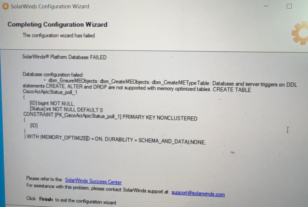

When setting up a new SolarWinds instance and creating the 3 databases, you may encounter the error "Error while executing script- Database and server triggers on DDL statements CREATE, ALTER and DROP are not supported with memory optimized tables" when running the configuration wizard.
The resource below is often used to resolve this issue; however, it can't be applied in this case as the configuration wizard failed to even create the database:
Configuration Wizard fails with an error "Error while executing script- Database and server triggers on DDL statements CREATE, ALTER and DROP are not supported with memory optimized tables."
This typically occurs due to DDL server-level policies on the SQL server, and it's recommended to disable them. However, if you are unable to disable the policies, as a potential workaround, you can migrate the SolarWinds database from a SQL server that doesn't have these policies to get around them.
Orion Platform
The configuration wizard is unable to create the database due to below error
The below KB cannot be used as the database has not been fully created yet. The configuration wizard marks that database as incomplete because it failed last time.
By running the script below, it was identified that server-level triggers were causing DDL triggers to be automatically applied, which in turn caused the configuration wizard to fail.
SELECT name, is_disabled
FROM sys.server_triggers;
The resolution would be to either disable any DDL triggers so that the SQL server doesn't apply them on table creation. Alternatively, in a new environment, as a potential workaround, create the SolarWinds databases using a SQL server that doesn't have any policies like this, migrate the tables, and run the configuration wizard.
