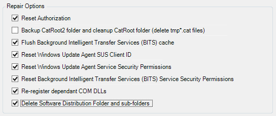

  4. Under Repair Options, select the options displayed below.
