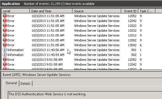

The Application Event Log on your Patch Manager server can also provide information about the errors. Below is an example of the Application Event Log when the error displays:
