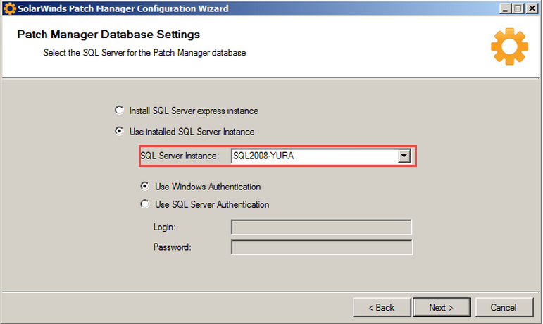

If you selected Default instance during the SQL Server installation, enter the server name in the SQL Server Instance field, as shown below. The installation procedure should proceed without generating an error.

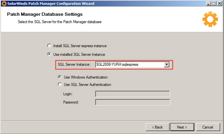

If you did not select Default instance during the SQL Server installation, enter the server name and instance name (SERVER_NAME\INSTANCE_NAME) in the SQL Server Instance field, as shown below. The installation should continue without generating an error.
Choose the SQL Server Instance based on the SQL Server version installed on your server.
