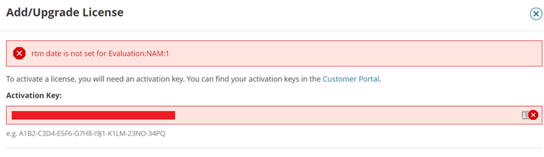

Error when activating license "rtm date is not set for eval:NAM:1" or "Evaluation:Observability:1"

License activation fails for bundled or observability licenses when trying to activate them in License Manager for a SolarWinds installation with individual installed modules.
rtm date is not set for Evaluation
Error details:
Network Performance Monitor
This error occurs when there is a mismatch of installed SolarWinds modules with license bundle being activated.
