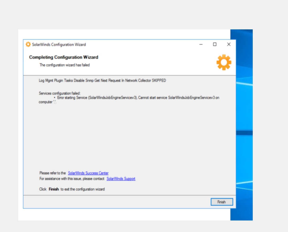

Following the upgrade to 2025.2, users may intermittently experience an error during the Configuration Wizard when the system attempts to start the SolarWinds JobEngine Service v3.
Symptoms:
  • Configuration wizard fails with an error message indicating the service cannot start.
  • The error message:
    "Error starting Service (SolarWindsJobEngineServicev3), Cannot start service SolarWindsJobEngineServicev3 on computer '.'."
  • The service may fail to start even after multiple attempts during the wizard process.
