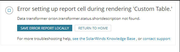

Error setting up report cell during rendering 'Custom Table.' Data transformer exchg.transformer.recipentty/pedetails not found.
The following error is received whenever the Users by Mailbox report is being viewed or edited.
10/31/2018 4:05 PM
2/12/2025 4:07 AM
Other errors:
Error setting up report cell during rendering '.'
Data transformer orion.transformer.status.shortdescription not found.
Also, when user is trying to preview the report, error below shows:
and, after clicking on "Vew Details", it's routed to the error below:
Other error from logs:
 ERROR SolarWinds.Orion.Web.Reporting.ReportCellPreviewControl+<>c__DisplayClass31_0 - (null)  Error setting up report cell during rendering '.'
