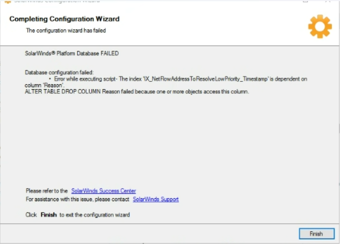

During an upgrade to SolarWinds Platform 2025.4, the Configuration Wizard may fail during the database configuration phase. The following error is displayed:
Database configuration failed:
• Error while executing script - The index 'IX_NetFlowAddressToResolveLowPriority_Timestamp' is dependent on column 'Reason'.
ALTER TABLE DROP COLUMN Reason failed because one or more objects access this column.

This prevents the upgrade from completing successfully and halts the Configuration Wizard process.
