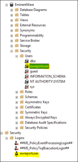

Expand EminentWare > Security Users and delete ewreportuser.

  2. Navigate to the Eminentware db > Security > Logins.
  3. Select ewreportuser.
  4. Right-click ewreportuser and click Delete.
  5. Navigate to Server Security > Logins.
  6. Select ewreportuser.
  7. Right-click ewreportuser and click Delete.

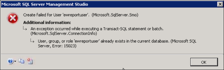

    If the following message displays, drop the old user.
  11. Go to the EminentWare db logins.
  12. Make sure the account appeared and has the proper permissions
