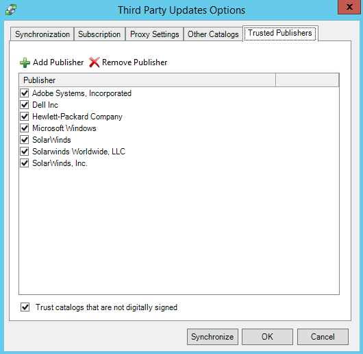

You can also add SolarWinds, Inc. to your third-party trusted publishers list by performing the following steps:
  1. Log in to the Patch Manager Administrator Console.
  2. In the navigation pane, expand Administration and Reporting and select Software Publishing.
  3. In the Actions pane, click Synchronize Settings.
  4. In the Third Party Updates Options dialog box, click the Trusted Publishers tab.
  5. Click Add Publisher.
  6. Perform one of the following:
    Click Add Publisher and enter:
    SolarWinds, Inc. (it may be already added)
    and
    Select the Trust catalogs that are not digitally signed checkbox.
  7. Click OK to save your changes.
