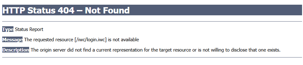

Error: HTTP Status 404 - Not found after upgrading DPA to 2025.4.0.511 (Linux environment)
DPA web interface issue post 2025.4.0.511 upgrade on Linux-OS
4/17/2026 3:11 PM
4/17/2026 3:11 PM
After upgrading DPA Linux environment to 2025.4.0.511, the DPA web interface returns "HTTP Status 404 - Not found" error.
