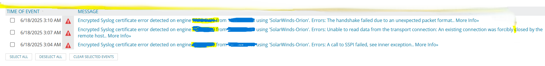

This article provides information to address the following Error Messages that are usually observed in all audit events.
Encrypted Syslog certificate error detected on engine <Engine name> from XX.XX.XX.XX using 'SolarWinds-Orion'. Errors: Unable to read data from the transport connection: An existing connection was forcibly closed by the remote host.
Encrypted Syslog certificate error detected on engine <Engine name> from XX.XX.XX.XX using 'SolarWinds-Orion'. Errors: The handshake failed due to an unexpected packet format.
Encrypted Syslog certificate error detected on engine <Engine name> from XX.XX.XX.XX using 'SolarWinds-Orion'. Errors: A call to SSPI failed, see inner exception..

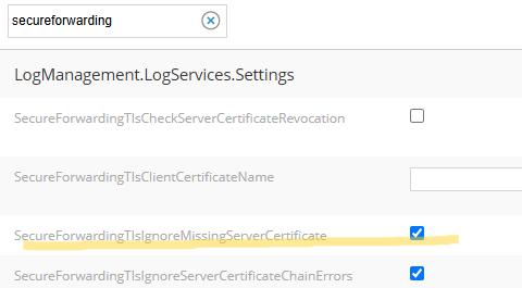

1. Log in to the SolarWinds Platform Web Console as an administrator.
2. Navigate to Advanced Configuration by adjusting the URL to: [hostname]/Orion/Admin/advancedconfiguration/global.aspx.
3. Search for "secureforwarding":
4. Please tick the checkbox next to SecureForwardingTlsIgnoreMissingServerCertificate
Once the required changes were made, please observe the issue for a few days, and these error messages will stop appearing.
