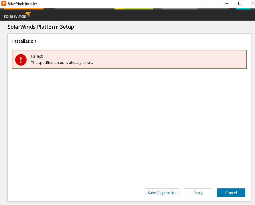

During an upgrade of the SolarWinds Platform (for example to version 2025.4.x), the installer may fail with the following message:

This is the only fatal error in the chain, and it causes the platform upgrade to terminate.
The failure happens during the creation of the SFTP/SCP Server service account . If the account already exists in Windows, the MSI refuses to continue and stops with Error 1603, which is standard Windows Installer behavior.
