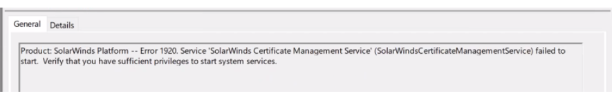

During installation or while running the Configuration Wizard, the installer may report that the SolarWinds Certificate Management Service failed to start and display a message to verify that the user has sufficient privileges to start system services.
Figure 1 below shows the Error 1920 installer dialog.
Figure 1: Error 1920 dialog showing that the SolarWinds Certificate Management Service failed to start during installation.

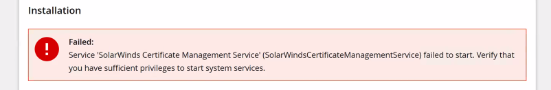

Figure 2 below shows the related installation failure banner for the same service.
Figure 2: Installation failure message indicating that the SolarWinds Certificate Management Service could not be started.

Although the installer message references privileges, this issue is commonly caused by a missing or mismatched .NET 8 runtime required by the SolarWinds Certificate Management Service rather than a true Windows permissions problem.
The SolarWinds Certificate Management Service runs as a Windows service under the LocalSystem account and depends on .NET 8.
A version mismatch between Microsoft ASP.NET Core Runtime and Microsoft .NET Desktop Runtime can prevent the service from starting.
In some environments, the same failure can also occur if the service cannot connect to the SolarWinds database during startup.
  1. Log on to the SolarWinds server using an account with local administrator rights and run the installer or Configuration Wizard using Run as administrator.
  2. Open Command Prompt or PowerShell and run the following command to review the installed runtimes.
dotnet --list-runtimes
  1. Verify that both of the following runtimes are installed and that they show the same 8.x version number.
  • Microsoft.AspNetCore.App
  • Microsoft.WindowsDesktop.App
  1. If the versions do not match, install or update the missing or mismatched runtime so that both runtimes are on the same version, and then restart the SolarWinds services.
  2. Run the installer or Configuration Wizard again after the runtime versions have been aligned.
