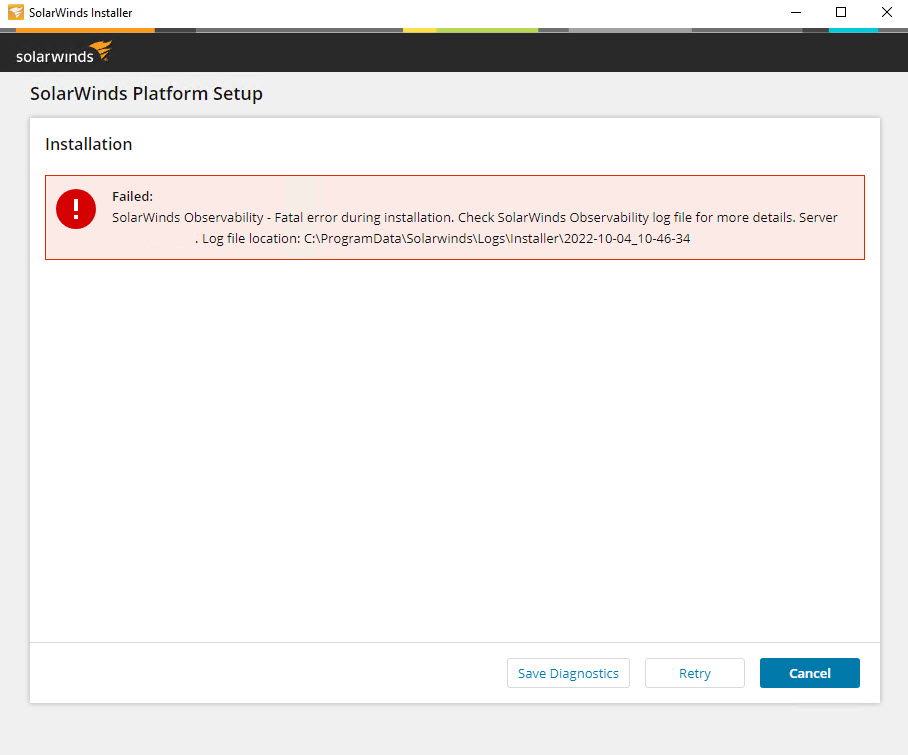

Error 1603 when trying to update the SolarWinds Platform
This article describes the issue when you upgrade some SolarWinds Platform based products, you see Fatal error in installer and the corresponding installer logs has ERROR 1603

This article describes the issue where receive the following errors when you are upgrading SolarWinds Platform products.

Orion Platform
File may be in use and windows installer is unable to update.
Resolution 1
1. Please use this MS tool to Uninstall the application that is failing to be upgraded or installed.
https://support.microsoft.com/en-us/topic/fix-problems-that-block-programs-from-being-installed-or-removed-cca7d1b6-65a9-3d98-426b-e9f927e1eb4d
2. Reboot and attempt to re-install
If the above method does not help, then continue to the next section.
Resolution 2
  1. Remove the corrupted machine.config file from C:\Windows\Microsoft.NET\Framework\v2.0.50727\Config\.
  2. Copy the same file from an old server backup.
  3. Save the old backup where you deleted the corrupted file.
  4. If you continue to get ERROR 1603, Restart the Server.
In most cases the Error 1603 refers to MSI installation - and is mostly caused by a process still running that cannot be stopped by the installer and hence cannot update the files related to that process.
So, make sure to check at what stage you are getting the error i.e. which module or dependencies installer was trying to update and check for the corresponding processes or dependency apps that module may be using or updating.
