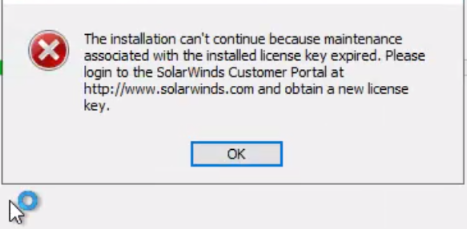

Engineer's Toolset (Desktop) upgrade fails with "The installation can't continue because the maintenance associated with the installed license key has expired"
Unable to upgrade the Engineer's Toolset Desktop (ETS Desktop) because of a false license error indicating that maintenance has expired

When upgrading to a later version of Engineer's Toolset Desktop (ETS Desktop), users may receive the following error message:
This error occurs even though the product has an active license and the license is activated in the SolarWinds License Manager.
Engineers Toolset
This error may occur for one of the following reasons:
  • The installed version of SolarWinds License Manager is not the latest version.
  • The user is upgrading from Engineer's Toolset Desktop 2025.2 or earlier to a later version. Starting with ETS Desktop 2025.3, the product supports both perpetual and subscription (term-based) licensing models, which require the latest version of SolarWinds License Manager to validate the license correctly.
If the steps in the following article do not resolve the issue:
SolarWinds ETS Desktop v2025.3 Installer Shows Maintenance Expired Error Despite Valid License
Perform the steps below:
