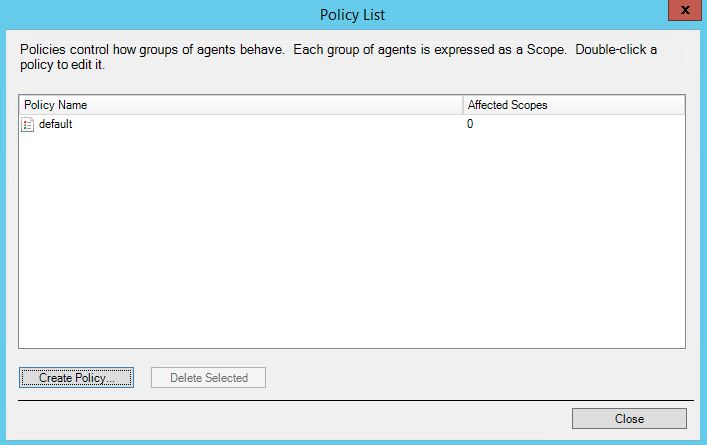

  4. Under Patch Manager System Tasks, click Policy Editor.
  5. In the Policy List window, click Create New Policy.

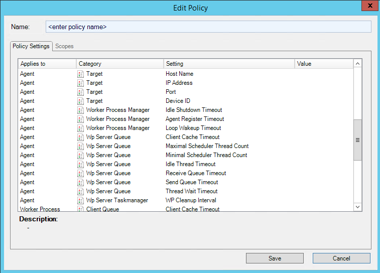

  6. In the Category column, locate the Target category.
  7. In the Target category, provide the following information about your Automation Server, and click Save:
    • IP Address
    • Device ID
    • Host Name
    • Port
