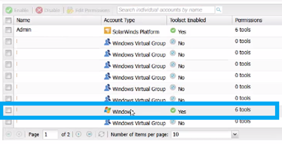

  • In order to view the Toolset options on version 2025.1, you would need to enable the ETS options for the user. Kindly follow the steps below.
1. In the Web Console, modify the URL in the browser using "Orion/Toolset/Admin/LicenseSettings/Default.aspx". For example, https://{hostname}/Orion/Toolset/Admin/LicenseSettings/Default.aspx. Kindly see the sample screenshot below.
2. Select place a check on the user.
3. Then click on Enable.

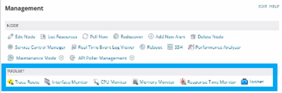

4. Log into the Web Console using the user credentials.
5. Go to a node and the user will be able to see the Toolset options now.
