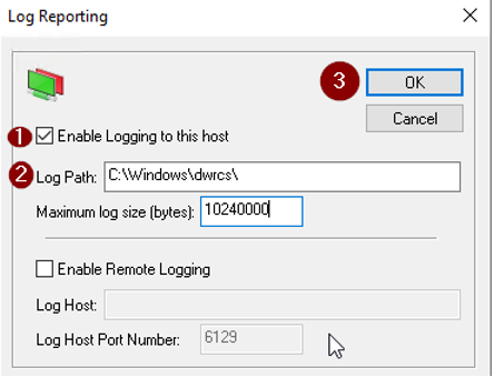

3. The machine receiving the Log Files must have the following settings defined within the DMRC Client Agent Service:
  • The "Enable Logging to this host" setting must be enabled
  • A Log Path for the local machine must be specified (i.e., C:\DameWare Log Files\ ).  A UNC path is not valid.
  • The Maximum Log File size must be specified in bytes.

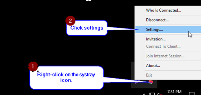

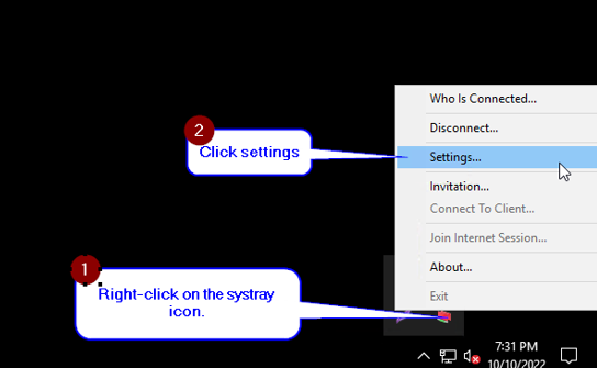

1. On the remote computer, right-click on the Dameware Mini Remote Control agent tray icon and select settings.

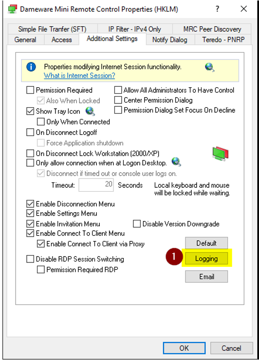

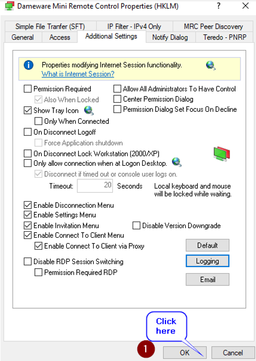

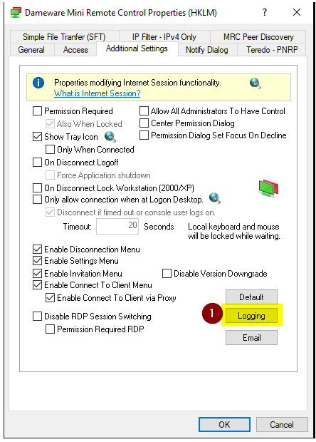

3. Go to Additional Settings and click Logging (1).

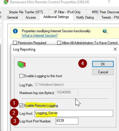

4. Click Enable Remote Logging (1) and enter the Log Host (2). Default Log Host Port Number is 6129 (3), then click OK (4).
5. Click OK again to save the new settings.

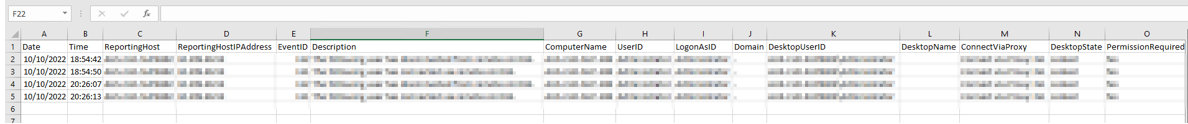

6. Disconnect the remote machine and connect again. It should create a CSV file. You can locate the file in the Dameware Log Server  (C:\Windows\dwrcs\DWRCS.csv). You can then convert it into an Excel file.
The sample result shows in the image below.

1. On the log server, right-click on the Systray (1) icon and select settings (2).
2. On the Additional Settings tab, click Logging (1).
3. Check the Enable Remote Logging check box (1) and enter the Log host (2), then click OK.

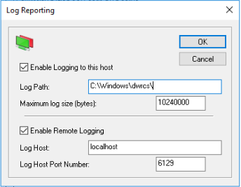

Note: For newer versions of Dameware, you need to set Enable Remote Logging to this host and specify the Log Host of the server as localhost:
4. Click OK to save the settings.
