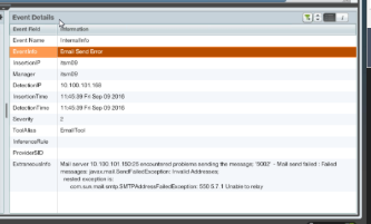

SEM Internal Events showing the following error:
5002 - Mail send failed: Failed message
550.5.7.1 Unable to relay

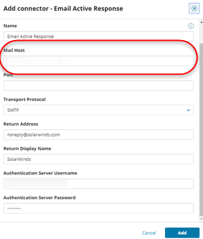

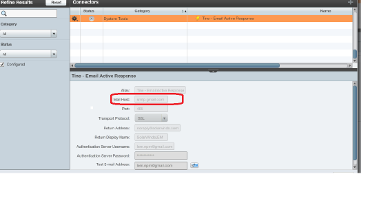

THE SEM Email Active Response connector does not work when using Microsoft Exchange Virtual IP (VIP).
Solution 1:
Change SEM Email Active Response connector settings for Mail Host to reflect the Exchange physical IP address instead of the VIP previously configured.
SEM Flash console
HTML5 SEM Events Console
