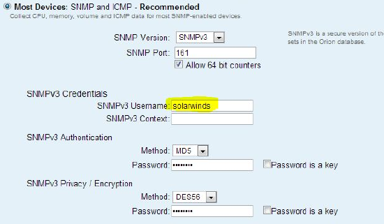

Make sure that the node is sending traps with the same SNMP user account that is used in the SolarWinds Platform when adding the node. The trap packet will only be recognized if it sent with the correct SNMP user account.
  1. Edit the node in the SolarWinds Platform and note down the SNMPv3 username. SolarWinds Platform Web Console > Go to the Node > Edit Node.
Note: The username is also shown in the nodes table in the SolarWinds Platform database.

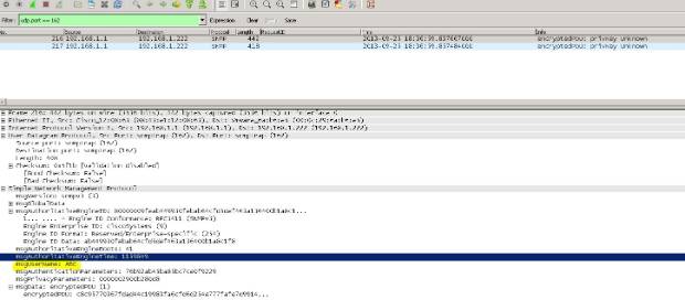

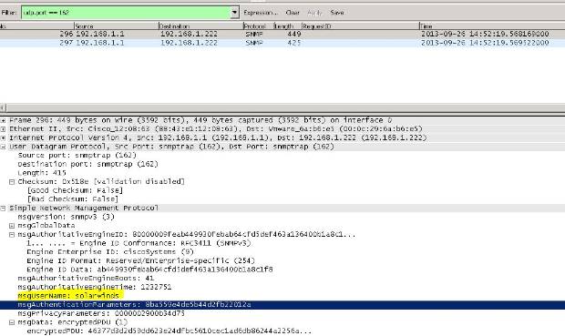

  1. Run Wireshark on the SolarWinds server to filter the traffic for traps sent by the node.
  2. The username that was previously should match the trap is received.

You will need to Run the Wireshark on the SolarWinds server. Filter the traffic for Traps sent by the Node and verify the User name should be matching when receiving the Trap. In the below packet capture example where the Trap is sent by the device (ie. 192.168.1.1 with user ABC) which caused the above Event that should be correct in the Node.
Following example included where the correct SNMP user is been sent by the node within Trap information
