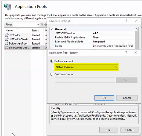

The NetworkService account likely is a part of GPOs or domain groups
  1. Stop all SolarWinds Platform services from the SolarWinds Platform Service Manager.
  2. Open IIS Manager.
  3. In the Connections pane, expand the Server Node and click Application Pools.
  4. On the Application Pools page, select SolarWinds Orion Application Pool then click Advanced Settings in the Actions pane.
  5. For the Identity property, click the ... button to open the Application Pool Identity dialog box.

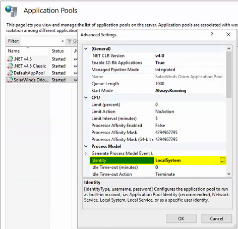

  1. Select the Built-in account option and select LocalSystem from the list and save the changes.
  1. Open CMD as an administrator and run:  IISreset.
  2. Start all SolarWinds Platform Services from the SolarWinds Platform Service Manager.
Note: If this resolves the issue, you will need to change the AppPool identity from NetworkService to LocalSystem each time that Configuration Wizard is run.
