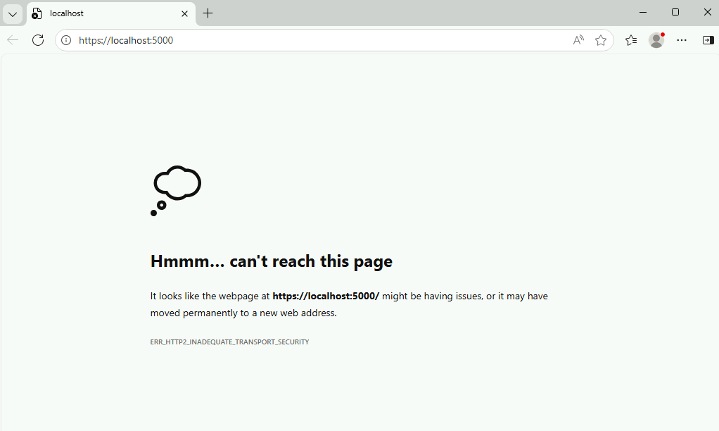

Kiwi Syslog NG uses HTTP/2 as its default transport protocol for the web interface. When accessing the web page, users may encounter the following error if the environment is configured to use HTTP/1.1 instead of HTTP/2:
ERR_HTTP2_INADEQUATE_TRANSPORT_SECURITY
This error indicates a transport protocol mismatch between the browser or system environment and the Kiwi Syslog NG web service.
Because HTTP/2 is required, environments that default to HTTP/1.1 can cause a security conflict, preventing successful access to the Kiwi Syslog NG web interface.

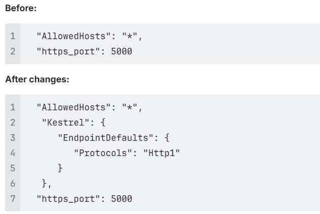

  2. Go to "C:\Program Files (x86)\SolarWinds\Kiwi Syslog Server NG" and look for appsettings.json.
  3. Create a backup of this file to a different location.
  4. Edit the original appsettings.json and apply the following changes:
    • "AllowedHosts": "*",
      "Kestrel":{
      "EndpointDefaults": {
      "Protocols":"Http1"
      "https_port": 5000
  5. Start the KSS NG service.
