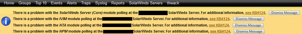

EOC Web Console error: There is a problem with the module polling
The EOC Web Console displays the following error: There is a problem with the moduleName module polling at the serverNameSolarWinds Server. For additional information, see KB4124.
There is a problem with the <moduleName> module polling at the <serverName> SolarWinds Server. For additional information, see KB4124.

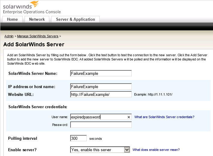

- Test the credentials for the Orion server listed in the error under Settings> Manage SolarWinds Servers.
- If the test fails and other causes have been ruled out, update the Orion server's credentials.
