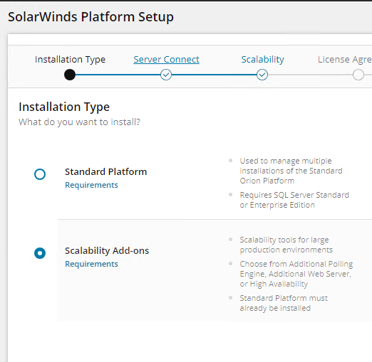

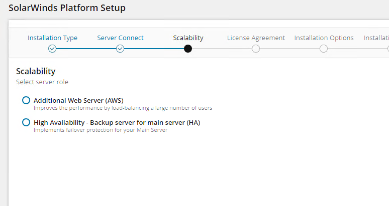

In an HCO environment, if you by mistake run the EOC installer on a separate server, the following screen is shown during the setup.
If you select Scalability Add-on on this screen.
And Additional Web Server
You will be able to connect to the HCO Main poller, and the installer will, by mistake, add the EOC to the environment.
In SWOSH 2024.4, this option allows you to go ahead if you type the HCO Main poller hostname / IP address instead of the EOC address.

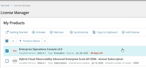

It also will add an EOC Evaluation license under License Manager.

The faster fix is to remove the EOC license restore the backup of the HCO database taken before the EOC installation and uninstall the EOC application.

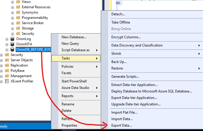

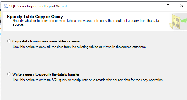

Then, using an old HCO database backup, you can copy the tables' contents by exporting the data (SQL Management Studio).

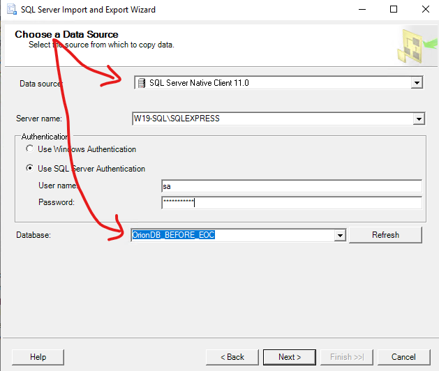

Select the data source (Backup DB - before installing EOC)

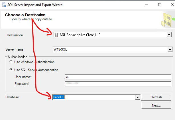

Select the Current database in Destination.
Select "Copy data from one or more tables or views"

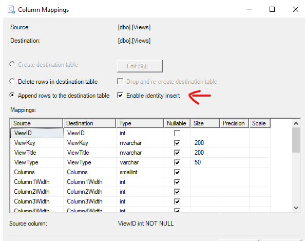

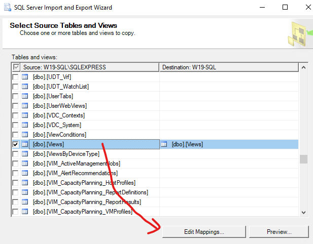

Select each truncated table, and click on Edit Mappings. (need to edit mappings for each truncated table)
Enable the option: "Enable identity insert"
Go next until finish. After that, the views and menus will be restored.
