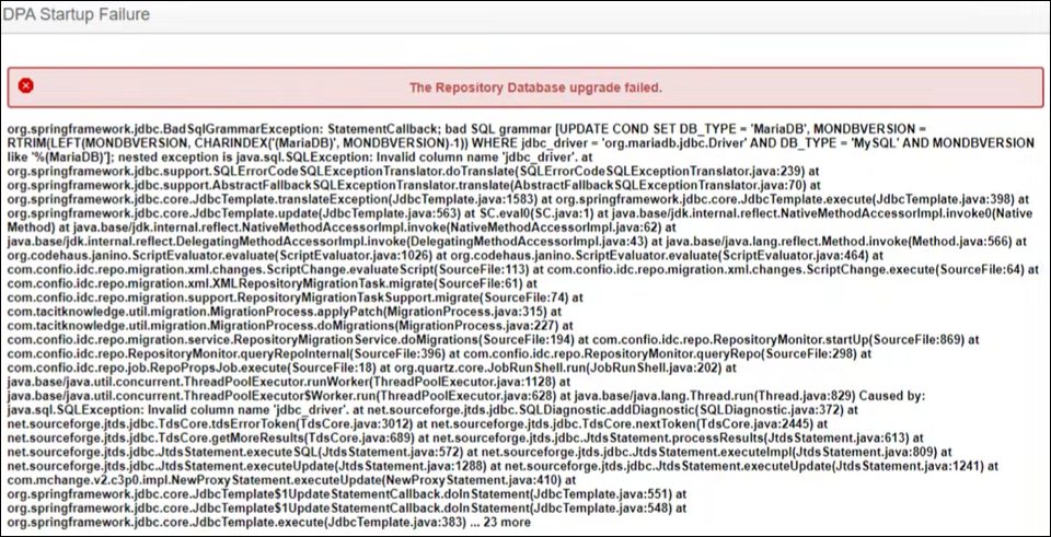

During an upgrade to DPA 2024.4 or 2024.4.100, the repository database upgrade fails with a message such as the following:
The Repository Database upgrade failed.
org.springframework.jdbc.Bad SqlGrammar Exception: StatementCallback; bad SQL grammar [UPDATE COND SET DB_TYPE = "MariaDB', MONDBVERSION - RTRIM(LEFT(MONDBVERSION, CHARINDEX((MariaDB), MONDBVERSION)-1)) WHERE jdbc_driver = 'org.mariadb.jdbc.Driver' AND DB_TYPE='MySQL' AND MONDBVERSION like % (MariaDB)]; nested exception is java.sql.SQLException: Invalid column name 'jdbc_driver'. at org.springframework.jdbc.support.SQLErrorCode SQLException Translator.do Translate(SQLErrorCode SQLException Translator.java:239) at org.springframework.jdbc.support.AbstractFallback SQLException Translator.translate(AbstractFallback SQLException Translator.java:70) at
org.springframework.jdbc.core.JdbcTemplate.translateException(JdbcTemplate.java:1583) at org.springframework.jdbc.core.Jdbc Template.execute(Jdbc Template.java:398) at org.springframework.jdbc.core.JdbcTemplate.update(Jdbc Template.java:563) at SC.eval0(SC.java:1) at java.base/jdk.internal.reflect.NativeMethodAccessorImpl.invoke0(Native Method) at

A script that is part of the repository database upgrade has the column name jdbc_driver in lowercase letters, which does not match the capitalization of the column name in the repository. Therefore, in case-sensitive databases, this column is not found.
SQL Server databases are case-sensitive by default. Oracle and MySQL databases can also be case-sensitive.
