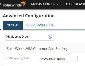

To Update settings
  1. Access to the Advanced Configuration http://<SolarWinds hostname or ip address>/Orion/Admin/AdvancedConfiguration/Global.aspx
    • https://support.solarwinds.com/SuccessCenter/s/article/Advanced-Configuration-access-in-Orion-Platform
  2. Search VMMappingOrder and then change the order to MAC,IP,HOSTNAME:
  3. Click save to apply the changes.
  4. Restart all services from the SolarWinds Platform Service Manager.

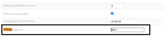

Note: If the resolution above doe not fix the issue, kindly follow the procedure below.
1. Please go to the /Orion/admin/advancedconfiguration/global.aspx and change the VMMappingOrder to only MAC:
2. Then delete and re-add the physical server. It should be working fine after that procedure.
