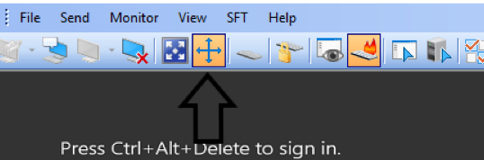

If you are running the same resolution on both, then click the MRC full-screen toolbar button to enter full-screen mode.

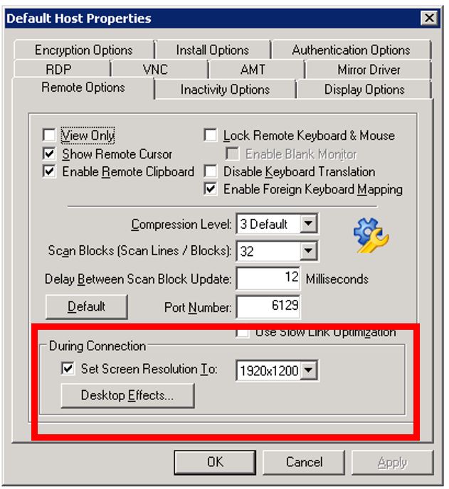

  1. Open Dameware MRC and go to view > Default Host Properties.
  2. Under the Remote Options tab, select Set Screen Resolution To and set the resolution according to your preference.
  3. Click OK.
If setting screen resolution does not help to make large remote screen window, you can use the smart sizing of Dameware. It will stretch the screen, but you may see a distorted display, but it is a good alternative if the remote screen window is really small.
